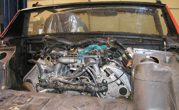

neo914-6   Tony at TC Design has made great progress on mount...   Apr 13 2006, 01:51 AM
neo914-6   can post pics now! :D   Apr 14 2006, 01:36 AM
neo914-6   Boxster Transaxle! Should have more pics tomo...   Apr 14 2006, 01:37 AM
neo914-6   Progress at TC Design: the engine and transaxle mo...   Apr 14 2006, 11:51 PM
