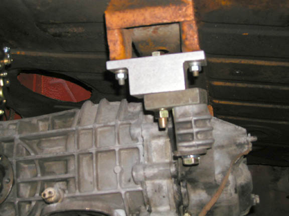

Forgot to mention, Remil (sj914) came by with some transmission brackets. (IMG:style_emoticons/default/smilie_pokal.gif) A few trips to OSH for Grade 8 bolts and they fit perfectly. Now to test the shifter bar I borrowed from Mark (Mar7ck)

neo914-6   I expected to use a hammer on the firewall for val...   Apr 2 2006, 01:07 AM
neo914-6   The fab'd transmission mount ala Brad N Crew w...   Apr 2 2006, 01:12 AM
neo914-6   Looks like I will need to shorten this...   Apr 2 2006, 01:13 AM
neo914-6   Or buy a Renegade adapters and sport trans mount (...   Apr 2 2006, 01:15 AM
Andyrew   You could just make that piece... solid aluminum. ...   Apr 2 2006, 04:53 AM
turbo914v8   I have a set of the Renegade adapters PM me if you...   Apr 2 2006, 10:11 AM

neo914-6   the differences between the bolt-on extension and ...   Apr 3 2007, 01:48 AM
neo914-6   other side   Apr 3 2007, 01:50 AM
