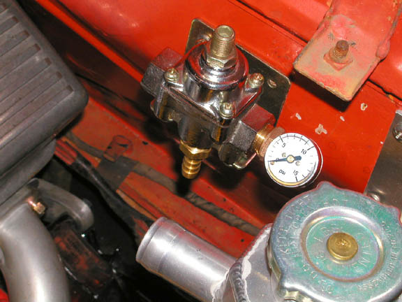

neo914-6   Found a nice small PSI gauge, mounted the regulato...   Apr 14 2006, 01:51 AM
