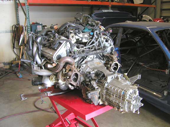

Progress at TC Design: the engine and transaxle mounts are done, sorry no closeups of the fine workmanship. The drivetrain is out so Tony can work on the front engine mount and fabricate an access panel for the back of the engine. The interesting thing is the drivetrain is designed asymetrical. The Boxster output flange sticks out on the left side and the other side is recessed. The Audi heads are slightly offset as well. (IMG:style_emoticons/default/confused24.gif) Not a problem just an observation...
The turbo outlets to downpipe are oval. Good thing I have the mating down pipe to modify...
