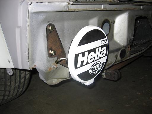

I'm looking for some ideas on how to mount a pair of auxillary driving lights
to my front bumper, NOT THE HOOD!
I've seen photos of GT's and rallay cars with the latger diamter lights mounted either to the inside or the outside of the OEM fog lights. Anyone have any ideas on what type of brackets are available or were fab'd up to do this?
I had thought of making a bracket that would bolt to the front bumper on 73's and 74's using the mounting holes for the rubber tits. Think that would work?

Getting close. I cut two units for test fit. These work well with my stock valance, special edition spoiler and my ultimate air dam. The bumper on this car is a fiberglass unit similar to a stock steel bumper, but I will not be able to try with a stock unit until next week.
These brackets mount under the stock bumper "dog bones" and are reversable so that you may mount the Hella 500s on the far outside of your bumper or closer to your stock "fog light" location. My test units will determine if welded gussets are needed, but at this time, I think not.
Still a few weeks away from production as I am finishing up some other projects, but at least there is a peek. Beta test units to go out next week .........

QUOTE(dlee1967 @ Feb 13 2006, 10:18 PM) *
David,
How are you coming along on the driving light brackets? Will these be available soon? Do the brackets fit between the bumper and valance?
