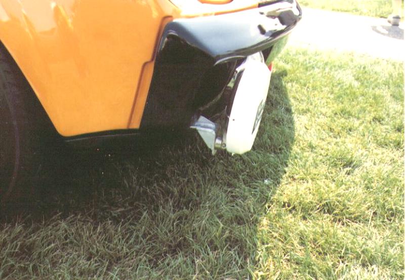

user posted image
user posted image

On a more serious note; those ones in your last picture don't look too stable. They look like they'd bounce a bit. The serious ones I've seen have bracing (Lufthansa car etc...)
Aaron Cox
QUOTE (Eric_Shea @ Feb 1 2006, 12:54 PM)
steel vs aluminum....
but your right. that isnt 1/8th steel.....

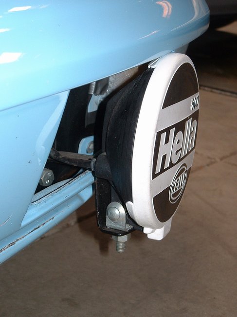

user posted image
user posted image

Getting close. I cut two units for test fit. These work well with my stock valance, special edition spoiler and my ultimate air dam. The bumper on this car is a fiberglass unit similar to a stock steel bumper, but I will not be able to try with a stock unit until next week.
These brackets mount under the stock bumper "dog bones" and are reversable so that you may mount the Hella 500s on the far outside of your bumper or closer to your stock "fog light" location. My test units will determine if welded gussets are needed, but at this time, I think not.
Still a few weeks away from production as I am finishing up some other projects, but at least there is a peek. Beta test units to go out next week .........
Aaron Cox
Freakin awesome david! i love how you can offset them left and right. thats genious!!!!

I believe the two gussets I've added will eliminate "movement" I saw on the first pass. The longer bracket also eliminated the fitment issues that Aaron saw on his steel bumpered car.
Did I mention the rear Hella foglight bracket? How did you like that? I believe it gives those who want the Euro look without drilling a stock bumper or valance for the light. I mocked up two bumper sections with the lights and brackets (front and rear), but have to help a neighbor by putting a PS pump on his plumbing van. NO pictures yet....... Pics to follow later in the week......

Front...final mockup before production pieces.....

looks good! looks like you found a stock bumper to see what i meant. looks awesome. thanks again for doin this!!
