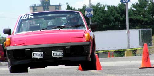

i have hella 500's and my mounts were going to use the bumper mount locations.
i have yet to mount mine,
last i heard David lee was working on a set (IMG:http://www.914world.com/bbs2/html/emoticons/smile.gif)
cant wait.
lemme know if you need pictures
(IMG:http://www.914world.com/bbs2/uploads/blog-1133924790.jpg)
(IMG:http://www.914world.com/bbs2/uploads/blog-1134788847.jpg)

On a more serious note; those ones in your last picture don't look too stable. They look like they'd bounce a bit. The serious ones I've seen have bracing (Lufthansa car etc...)
steel vs aluminum....
but your right. that isnt 1/8th steel.....

QUOTE (Aaron Cox @ Feb 1 2006, 10:24 AM)
Doesn't using the bumper mounts for your driving lights eliminate the use of the OEM fog lights? I want to have both available for use.
Aaron Cox
post Feb 1 2006, 05:10 PM
Professional Tinkerer
Posts: 24,548
Joined: 1-February 03
From: Corona, CA
Member No.: 219
nope. they sit outboard of the OEM fogs.....
im wired for both too....
330 watts of light at my command (6x55)
