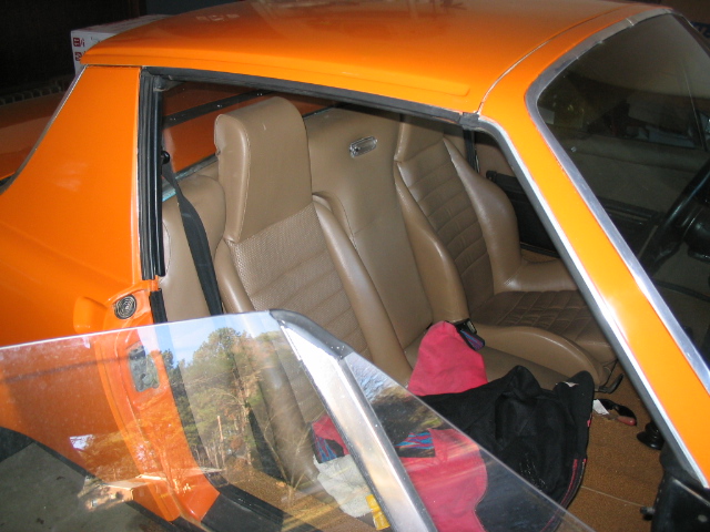

I don't know who's this is but the seat was done like an early 911 sport seat. I have a set in my 944 and they are really nice. This is the 3rd car I've put them in now! I plan on making a set of these for my teener when I get started on it (IMG:style_emoticons/default/confused24.gif)

scotty b   I don't know who's this is but the seat wa...   Apr 18 2006, 06:00 PM
