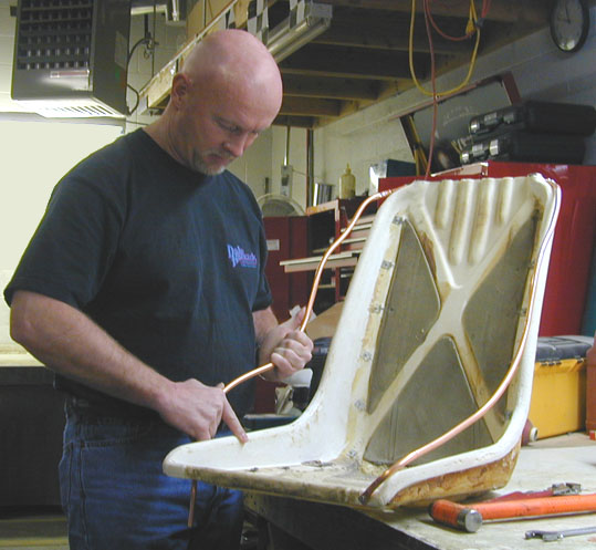

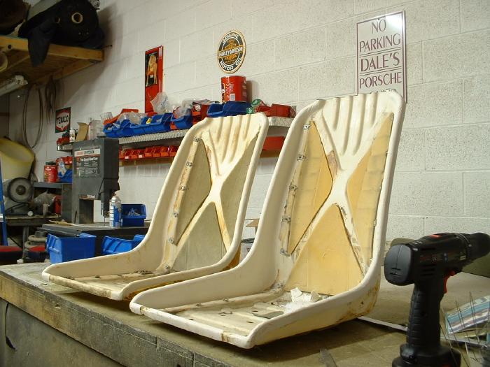

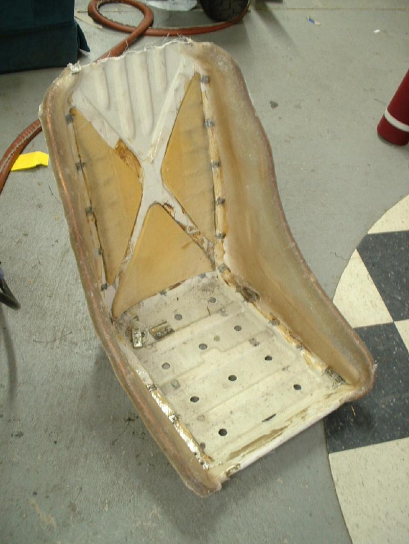

I'm building GT seat replicas off the original frame. I used the Recaros from my 911RS to form the side bolster. Used Copper tubing as the template. They're going to have the same cord inserts as the Recaros. Here's some pics:

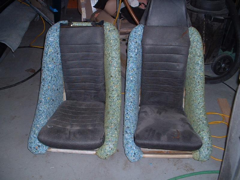

trekkor   first cut... I spotted it with foam one more time...   Apr 21 2006, 12:23 AM

trekkor   The copper is fastened with pop rivets. Two on eac...   Apr 21 2006, 10:36 AM
trekkor   Foam shaped to my liking, followed by the first co...   Apr 21 2006, 02:15 PM

trekkor   It is taking a little more material than I planned...   Apr 21 2006, 02:21 PM
jgara962   Looking good! How much do you think this proj...   Apr 21 2006, 02:41 PM
trekkor   $140 in materials. Don't count the time ...   Apr 21 2006, 03:39 PM
Demick   Mine cost about $100 in materials (that was e...   Apr 21 2006, 03:47 PM
Dan (Almaden Valley)   Trekkor, With the shoulder "wings" as wi...   Apr 21 2006, 03:54 PM
grantsfo   Do they have running water? :lol: ...love the co...   Apr 21 2006, 04:18 PM
Aaron Cox   looks "interesting" and did you get the...   Apr 21 2006, 05:54 PM
trekkor   The seat does not slide all the way back. that...   Apr 21 2006, 07:43 PM

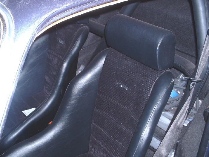

trekkor   I'm still happy... KT   Feb 8 2007, 04:26 PM

John   The shoulder thing makes all kinds of sense, but i...   Feb 8 2007, 10:05 PM
So.Cal.914   I highly recommend padding the seat bottom and t...   Feb 9 2007, 12:30 AM
trekkor   I can still use the stock seat cushion and tuck aw...   Feb 9 2007, 12:14 AM
