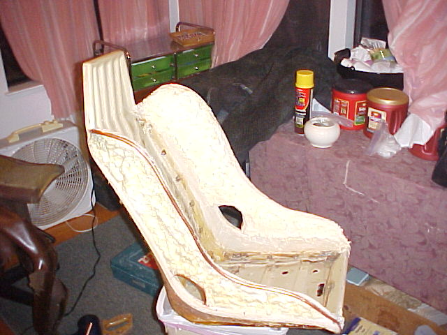

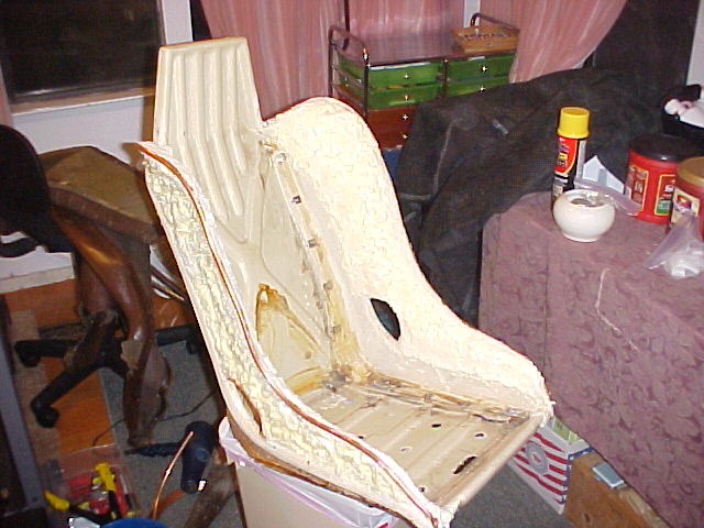

first cut...
I spotted it with foam one more time.
I sat in it (IMG:style_emoticons/default/unsure.gif)
Pretty cool (IMG:style_emoticons/default/cool_shades.gif)
KT

trekkor   first cut... I spotted it with foam one more time...   Apr 21 2006, 12:23 AM

trekkor   The copper is fastened with pop rivets. Two on eac...   Apr 21 2006, 10:36 AM
trekkor   Foam shaped to my liking, followed by the first co...   Apr 21 2006, 02:15 PM

trekkor   It is taking a little more material than I planned...   Apr 21 2006, 02:21 PM
jgara962   Looking good! How much do you think this proj...   Apr 21 2006, 02:41 PM
trekkor   $140 in materials. Don't count the time ...   Apr 21 2006, 03:39 PM
