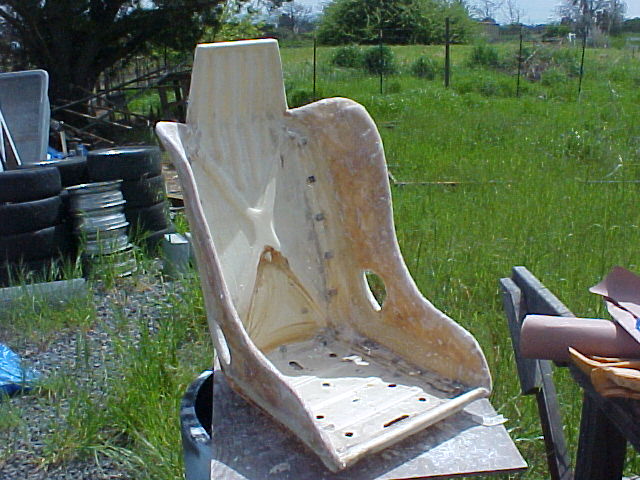

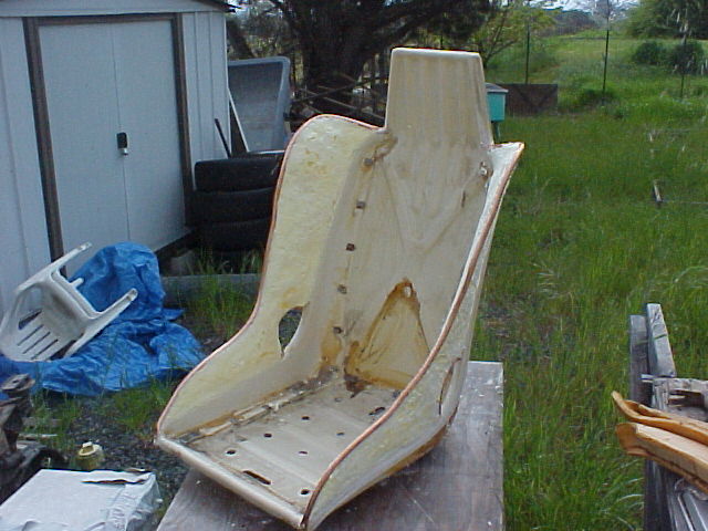

Foam shaped to my liking, followed by the first coat of resin and glass matte.
Sanded.
Ready for a final coat of resin and glass cloth.
KT

Very Cool! Can't wait to see the finished product. You've got me thinking about modifying one my seats as well.
