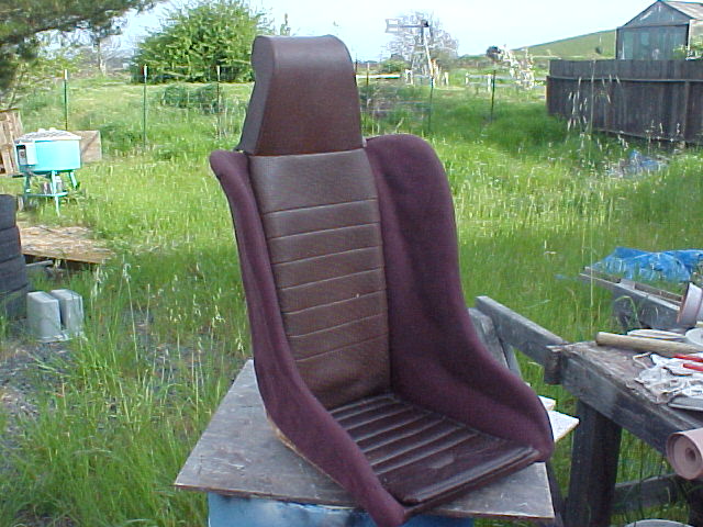

I know some have done this...Demick.
I'd like to see some examples.
I'm tossing around the idea of glassing on full bolstering and covering with vinyl to match.
I like the ready to buy seats and all. I also like a good project, too.
thanks, KT (IMG:style_emoticons/default/clap56.gif)

The seat does not slide all the way back. that's OK though.
I run with the seat pretty far foward.
Here's the end of the show. I'm pretty tired.
I don't like the color of the fabric I am using, but for $6, enh?
Just getting by for now.
KT

trekkor   first cut... I spotted it with foam one more time...   Apr 21 2006, 12:23 AM

trekkor   The copper is fastened with pop rivets. Two on eac...   Apr 21 2006, 10:36 AM
trekkor   Foam shaped to my liking, followed by the first co...   Apr 21 2006, 02:15 PM

trekkor   It is taking a little more material than I planned...   Apr 21 2006, 02:21 PM
jgara962   Looking good! How much do you think this proj...   Apr 21 2006, 02:41 PM
trekkor   $140 in materials. Don't count the time ...   Apr 21 2006, 03:39 PM

trekkor   The seat does not slide all the way back. that...   Apr 21 2006, 07:43 PM
trekkor   Of course it's installed :boing: I've go...   Apr 21 2006, 07:49 PM
