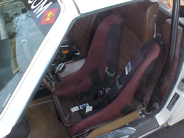

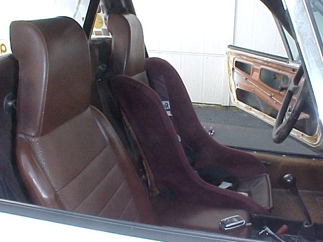

trekkor   first cut... I spotted it with foam one more time...   Apr 21 2006, 12:23 AM
messix   bolstering for the shoulders has been found to be ...   Apr 21 2006, 12:49 AM
Hydra   Great thread trekkor! One question remains, ho...   Apr 21 2006, 04:39 AM
trekkor   The copper is fastened with pop rivets. Two on eac...   Apr 21 2006, 10:36 AM
trekkor   Foam shaped to my liking, followed by the first co...   Apr 21 2006, 02:15 PM
nynone4   Very Cool! Can't wait to see the finished ...   Apr 21 2006, 02:20 PM
trekkor   It is taking a little more material than I planned...   Apr 21 2006, 02:21 PM
jgara962   Looking good! How much do you think this proj...   Apr 21 2006, 02:41 PM
trekkor   $140 in materials. Don't count the time ...   Apr 21 2006, 03:39 PM
Demick   Mine cost about $100 in materials (that was e...   Apr 21 2006, 03:47 PM
Dan (Almaden Valley)   Trekkor, With the shoulder "wings" as wi...   Apr 21 2006, 03:54 PM
grantsfo   Do they have running water? :lol: ...love the co...   Apr 21 2006, 04:18 PM
Aaron Cox   looks "interesting" and did you get the...   Apr 21 2006, 05:54 PM
trekkor   The seat does not slide all the way back. that...   Apr 21 2006, 07:43 PM
trekkor   Of course it's installed :boing: I've go...   Apr 21 2006, 07:49 PM
sixnotfour   Trekkor, you the man :thumbsup:   Apr 21 2006, 08:01 PM
J P Stein   I like to see guys that aren't afraid to build...   Apr 21 2006, 08:23 PM
Dan (Almaden Valley)   Looks like you shouldn't be sliding around any...   Apr 21 2006, 08:27 PM
trekkor   Thanks, guys. I had fun on this project. That was...   Apr 21 2006, 09:53 PM
