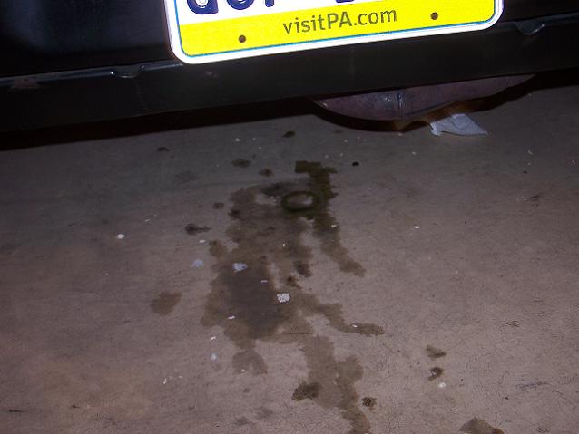

Where did you get the seal and o-ring? I have the same issue and was going to start a thread about fixing it.
