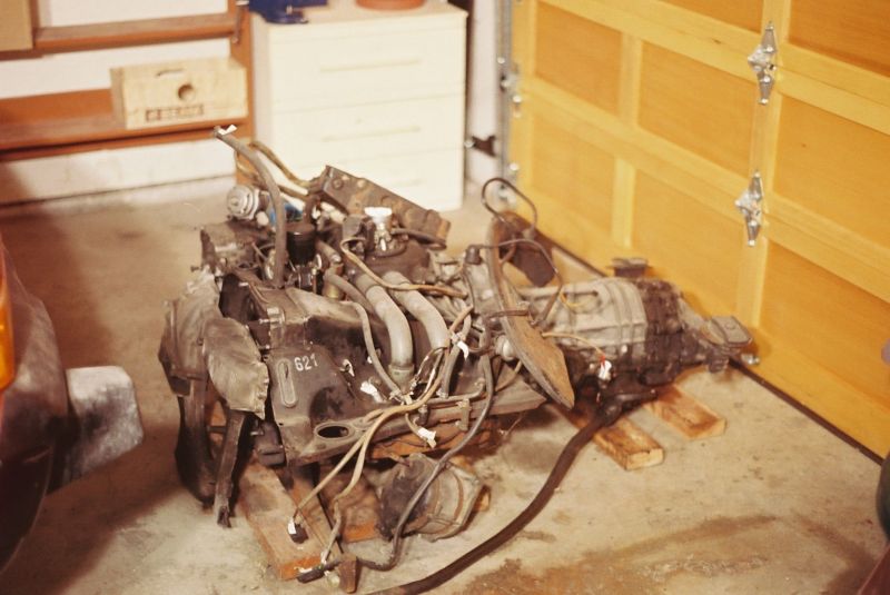

Charles Deutsch
post Sep 30 2003, 01:53 PM
Unregistered
Here's my '73 2.0 that's in good rebuildable condition (it would run now with a new MPS, vacuum hoses etc.) but I'm keeping it while I build a big-four from a 1.8 that I'm buying.
