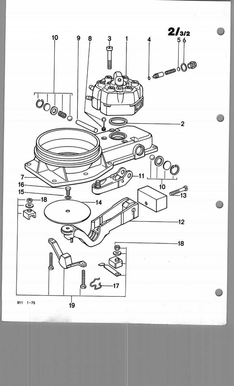

Looking at this diagram I see where the adjust bolt should be, but instead it is like a hook.
Also, I do not see a shim under the plate. I am missing the washer on top, but it is of no consequence with my given problems.

Dr Evil   And today in /6 news.... So I took the air filter...   Jun 13 2006, 05:05 PM
Dr Evil   Looking at this diagram I see where the adjust bol...   Jun 13 2006, 10:31 PM
sixnotfour   #8 on your diagram is the plug pull it out and ins...   Jun 13 2006, 10:41 PM
Dr Evil   The more I study the diagram the more I realize th...   Jun 13 2006, 10:46 PM
Dr Evil   Ayup, I do not have a #8.....might be a problem.   Jun 13 2006, 10:47 PM
sixnotfour   alot of them are missing #8 , not an air leak for ...   Jun 13 2006, 10:55 PM
