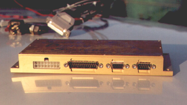

Mark Henry
post Oct 2 2003, 08:25 PM
that's what I do!
Posts: 20,065
Joined: 27-December 02
From: Port Hope, Ontario
Member No.: 26
How they plug in.

Mark Henry   SDS ECU and coil.   Oct 2 2003, 08:24 PM
Mark Henry   How they plug in.   Oct 2 2003, 08:25 PM
Mark Henry   sorry I forgot the pic: the SDS ECU and coil.   Oct 2 2003, 08:30 PM
