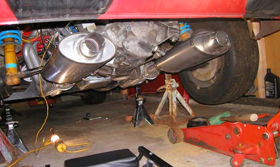

neo914-6   I expected to use a hammer on the firewall for val...   Apr 2 2006, 01:07 AM
neo914-6   The fab'd transmission mount ala Brad N Crew w...   Apr 2 2006, 01:12 AM
neo914-6   Looks like I will need to shorten this...   Apr 2 2006, 01:13 AM
neo914-6   Or buy a Renegade adapters and sport trans mount (...   Apr 2 2006, 01:15 AM

neo914-6   I :smash: clearance for the tall valve covers (th...   Apr 14 2006, 01:45 AM
neo914-6   Forgot to mention, Remil (sj914) came by with some...   Apr 14 2006, 01:48 AM
neo914-6   Found a nice small PSI gauge, mounted the regulato...   Apr 14 2006, 01:51 AM

neo914-6   A few issues to resolve before it can be driven bu...   Jul 20 2006, 01:32 AM
Dr. Roger   geez, i was just getting ready to crash and i noti...   Jul 20 2006, 02:13 AM
