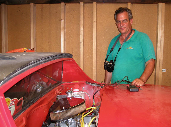

A few issues to resolve before it can be driven but it fires up!!! (IMG:style_emoticons/default/beerchug.gif) I probably woke up half the neighborhood. (IMG:style_emoticons/default/laugh.gif) I left a message with Harry firing it up, he's been calling me almost every day for updates.
Just over a year ago my friend John helped me clear the garage to begin this resurrection. New Renegade kit, new (to me) full Edelbrock 400hp 350, and alot of relearning what I had basically done over 20 years ago with the Jaide kit and 283. The Renegade kit should have only take me a few weekends to bolt in, yeah right! (IMG:style_emoticons/default/screwy.gif) John held the fire extinguisher and witnessed the event. (IMG:style_emoticons/default/laugh.gif)
