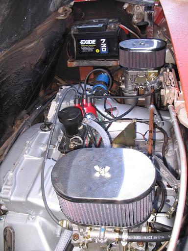

Engine is:
66mm Crank, 96mm P+C's (1911cc)
2.0L heads with 48x38 valves
Eurorace H-Grind Camshaft
Dual Weber 40IDF with CB Performance Linkage
Mallory Unilite Distributor with Vac Advance
Ceramic coated European Racing Headers with a Magnaflow exhaust
etc etc etc..
Starts up like a champ, runs nice and smooth all the way to 4k rpm.. haven't done any higher revs than that.
I'll try fscking with the splines under the 'center seat' a little bit more.
