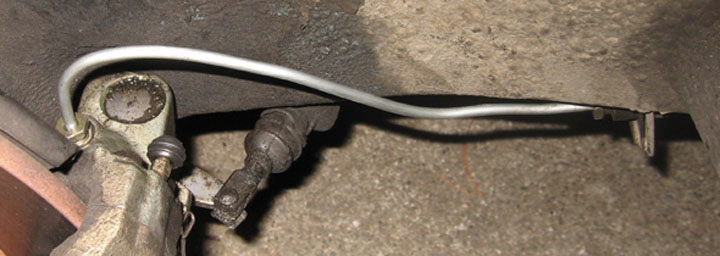

After a bit of bending the 12" line fits perfectly. Here's a picture of the finished line on the car. Bleed the brakes, put the wheel back on, and its ready to autocross on Sunday.
