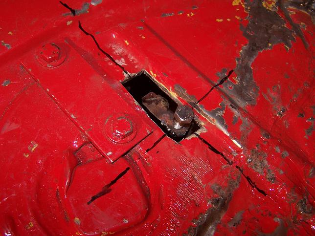

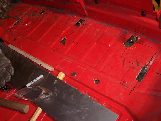

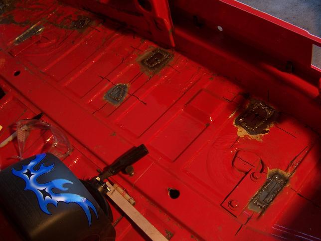

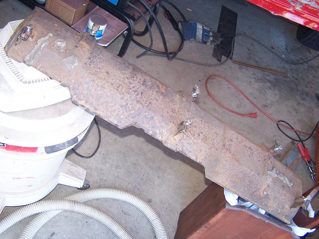

I removed the heat shield to do some collision damage and decided to keep the shield and make it removable. I was already doing some welding so didnt matter on the size of the holes that I made. In some cases, I couldn't find the weld and the holes got a bit large.
Welded bolts to the mounting tabs and was able to bolt on and remove at will if needed. Does help keep the trunk a bit cooler. I replaced the shield just because it was original equipment and no need to remove it permanently.
