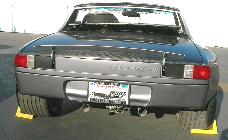

Here's the bumperettes mocked up...
and the final bumper, sans bumperettes

neo914-6   The composite rear bumper is further along but I...   Sep 21 2006, 02:03 AM
neo914-6   Here's the bumperettes mocked up... and the f...   Nov 18 2006, 12:45 AM

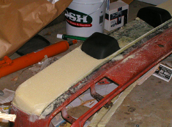

neo914-6   I started with bonding a f/g Rennspeed bumper and ...   Nov 18 2006, 01:15 AM
