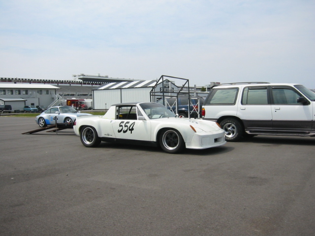

My car is low, I am using the same front struts as you (RSR raised spindle) at this ride height I only have about 2 in of shock travel. I have 1/3 of the bumper installed.
