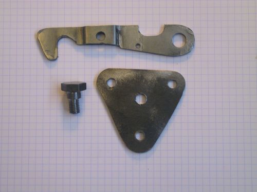

Anyone have any good pics or info on how the 914 GT headlight mechanism (with the cable release) worked? I'd like to come up with something similar for my car if it's not too difficult. I have an idea of how I could fabricate the lift mechanism - I just wonder how they fastened back down when closed.

FWIW, here's a picture of the parts I made for my car. 5 mm squares.
Not perfect, by any stretch, but they work:

michel richard   FWIW, here's a picture of the parts I made for...   Dec 27 2006, 01:00 PM
michel richard   The splitter. The threads did'nt come out str...   Dec 27 2006, 01:01 PM
michel richard   I used ordinary bicylcle brake cables. The expens...   Dec 27 2006, 01:04 PM
michel richard   The inside of the forward compartment has since be...   Dec 27 2006, 01:05 PM
michel richard   And how the hook looks in the car. The way it wor...   Dec 27 2006, 01:09 PM
