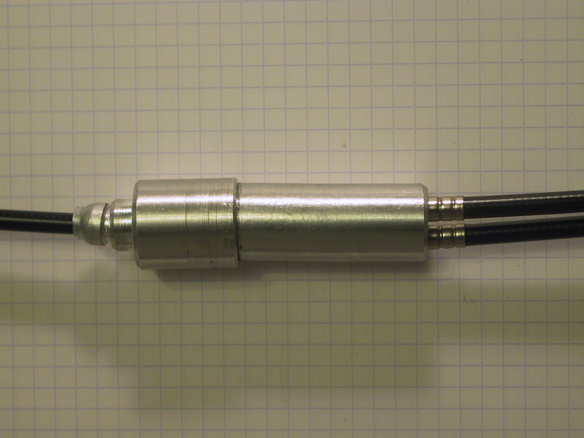

The splitter. The threads did'nt come out straight, and I redid this part. I used 3/4 inch round aluminum stock.

michel richard   FWIW, here's a picture of the parts I made for...   Dec 27 2006, 01:00 PM
michel richard   The splitter. The threads did'nt come out str...   Dec 27 2006, 01:01 PM
michel richard   I used ordinary bicylcle brake cables. The expens...   Dec 27 2006, 01:04 PM
