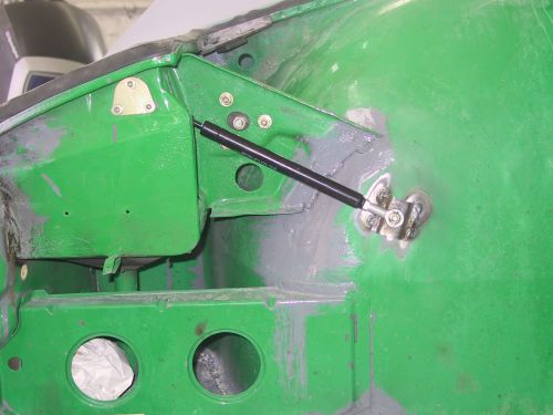

michel richard   FWIW, here's a picture of the parts I made for...   Dec 27 2006, 01:00 PM
michel richard   The splitter. The threads did'nt come out str...   Dec 27 2006, 01:01 PM
michel richard   I used ordinary bicylcle brake cables. The expens...   Dec 27 2006, 01:04 PM
michel richard   The inside of the forward compartment has since be...   Dec 27 2006, 01:05 PM
michel richard   And how the hook looks in the car. The way it wor...   Dec 27 2006, 01:09 PM

michel richard   Here's a closeup of the shock. You can see th...   Dec 27 2006, 04:00 PM
michel richard   and an overall photo of the finished product. Thi...   Dec 27 2006, 04:03 PM

michel richard   Mounting the shock to have it perpendicular at mid...   Jan 10 2007, 01:05 PM
