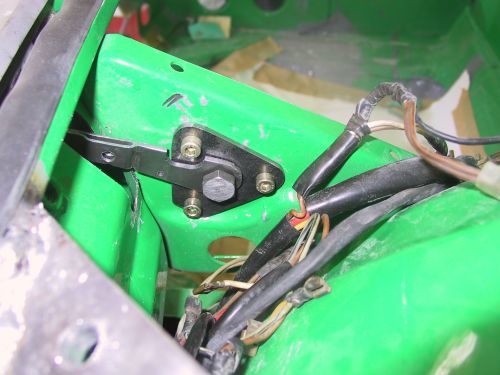

And how the hook looks in the car.
The way it works is this: the hook and the gas spring both engage the same special fitting on the headlight. The cables simply lift the hook so that the gas spring can do it's work and push the headlight open. The head light can only be shut by hand, from the outside: the hook is shaped such that pushing the headlight down will push the hook forward until it drops past the fitting on the headlight.
The bucket has to be modified by adding a vertical slot inside the side support to let the hook through.

michel richard   FWIW, here's a picture of the parts I made for...   Dec 27 2006, 01:00 PM
michel richard   The splitter. The threads did'nt come out str...   Dec 27 2006, 01:01 PM
michel richard   I used ordinary bicylcle brake cables. The expens...   Dec 27 2006, 01:04 PM
michel richard   The inside of the forward compartment has since be...   Dec 27 2006, 01:05 PM
michel richard   And how the hook looks in the car. The way it wor...   Dec 27 2006, 01:09 PM
