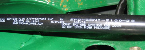

Here's a closeup of the shock. You can see the part number spd-gsni-5100-20 as well as the website www.spdhardware.com . I just looked it up and saw that it's 12 bucks, or so. My memory was off. You also need to get the proper end fittings, 4 of those.
The lights are quite easy to push down. Actually, if anything, mine sometime hesitate to come up, so a slightly stiffer spring may not be a bad idea. These do work, though.

project-914   how hard is each headlight to push down with those...   Dec 27 2006, 03:06 PM

project-914   looks like you got the 20lbs ones...I'll try t...   Dec 27 2006, 05:27 PM
michel richard   More leverage is the way I would start. A small ga...   Dec 27 2006, 05:40 PM
project-914   would you recommend me getting 30lbs ones or would...   Dec 27 2006, 06:17 PM
michel richard   I think the 20 lbs are enough, with careful design...   Dec 27 2006, 08:52 PM
project-914   k I'll go 20lbs...what's another 30 bucks ...   Dec 27 2006, 09:23 PM
