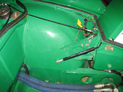

and an overall photo of the finished product. This can all be done with a good bench vise, a hacksaw, a few files, the most basic welding equipment (it can probably be done with brazing) and some elbow grease. Actually, I made the splitter on my lathe. If you don't have one, something would have to be imagined.
Edit: actually, now that I think about it, the little fitting on which the forward end of the shock attaches, and on which the hook hooks, has to be turned on a lathe too. Both the parts that need to go on the lathe are pretty simple. I suspect that making parts that are nice enough to sell is much more expensive than just knocking something off in my basement. Plus there's the metal finishing, either zinc or paint or whatever, that involves significant cost. (I simply applied POR-15 on mine).
HTH

michel richard   FWIW, here's a picture of the parts I made for...   Dec 27 2006, 01:00 PM
michel richard   The splitter. The threads did'nt come out str...   Dec 27 2006, 01:01 PM
michel richard   I used ordinary bicylcle brake cables. The expens...   Dec 27 2006, 01:04 PM
michel richard   The inside of the forward compartment has since be...   Dec 27 2006, 01:05 PM
michel richard   And how the hook looks in the car. The way it wor...   Dec 27 2006, 01:09 PM

michel richard   Here's a closeup of the shock. You can see th...   Dec 27 2006, 04:00 PM
michel richard   and an overall photo of the finished product. Thi...   Dec 27 2006, 04:03 PM

michel richard   More leverage is the way I would start. A small ga...   Dec 27 2006, 05:40 PM
project-914   would you recommend me getting 30lbs ones or would...   Dec 27 2006, 06:17 PM
michel richard   I think the 20 lbs are enough, with careful design...   Dec 27 2006, 08:52 PM

michel richard   Ok, drove home quick over lunch, snapped some pict...   Jan 5 2007, 12:27 PM
michel richard   the actual measurment:   Jan 5 2007, 12:27 PM

michel richard   Mounting the shock to have it perpendicular at mid...   Jan 10 2007, 01:05 PM
