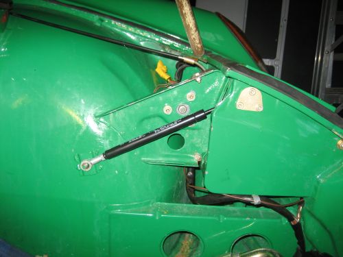

Ok, drove home quick over lunch, snapped some pictures.
Here is the shock in the closed position. I think that I put the anchor point too low. It's at the start of the movement that it hesitates and improving the geometry at that point is probably all that's needed.
Mind you, I only had a problem when trying to raise the lights and the car was stationnary. As soon as I move, the slightest bump will get them on their way up.

michel richard   Here's a closeup of the shock. You can see th...   Dec 27 2006, 04:00 PM

michel richard   Ok, drove home quick over lunch, snapped some pict...   Jan 5 2007, 12:27 PM

michel richard   Mounting the shock to have it perpendicular at mid...   Jan 10 2007, 01:05 PM
