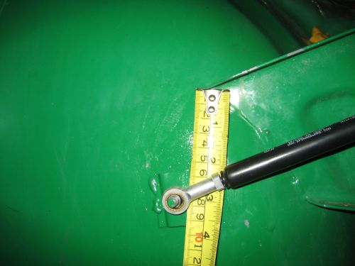

michel richard   Ok, drove home quick over lunch, snapped some pict...   Jan 5 2007, 12:27 PM
michel richard   the actual measurment:   Jan 5 2007, 12:27 PM

project-914   Ok, drove home quick over lunch, snapped some pic...   Jan 5 2007, 05:46 PM
michel richard   Mounting the shock to have it perpendicular at mid...   Jan 10 2007, 01:05 PM
