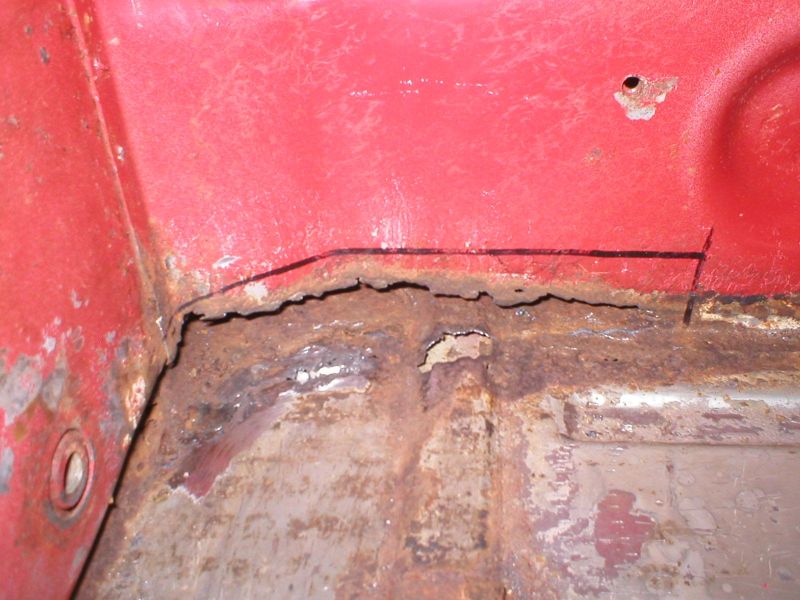

Worked on the car again this weekend. It was a very productive one, too. I began working on the interior. I began by removing the tar on the floor and the glue from the rear firewall. After removing the seam sealer in the corner of the floor, I found a section behind the passenger seat had rusted out.
Here's the before shot...

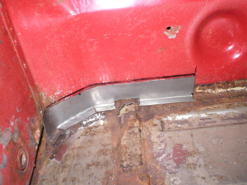

Here's the batch that I created...

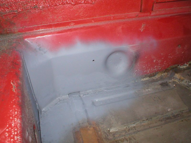

After cutting, fitting, welding, bondoing, spraying primer, here's the final piece... after about 6 hours...
