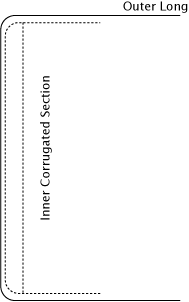

What cool perspective of the hell hole area.
There is one part that is not quite original though. I'm sure it's made that way for ease of manufacturing, but it's worth pointing out for educational purposes.
This portion is double layered in the original pieces. The 'corrugated' metal was a C shape that fit inside the U shaped inner longitudinal.
obscurity
post Jan 12 2007, 04:31 PM
Posts: 413
Joined: 24-February 06
From: Atlanta ,GA
Member No.: 5,628
QUOTE(McMark @ Jan 12 2007, 03:59 PM) *
If you are replacinga portion the section you are indicating with the ribs, Does anyone know if it will be as strong as the original? You would have a portion with the ribs and a portion with the inner stiffener. With the inner stiffener only spot welded to the outer skin wouldn't it be difficult to get it integrated with the new ribbed skin? I hope I explained that clearly...
