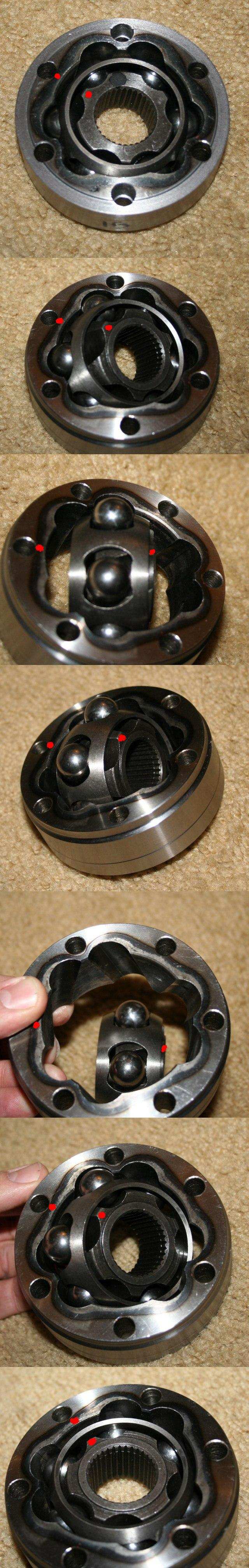

So I'm assembling the drive axles and those pesky cv joints won't stay put. One I accidentaly dropped and it came apart, the other, well, it basically came apart too.
I've heard reassembly to be similar to solving the rubiks cube...never did it without taking it apart or just changing the stickers.
Tips and tricks?

follow the red spots..pay attention to the how the "point" goes to the "wide" section of the mating part.
starting at the top picture, if both hands are on the CV at the 9 and 3 o'clock postion, your fingers on your left hand would be pushing "up" while your thumb on the right hand would be pushing down.
When the middle section is about 90° to it's original postion, it will slide right out (with a little help, but not much)
reassembly is reverse...
