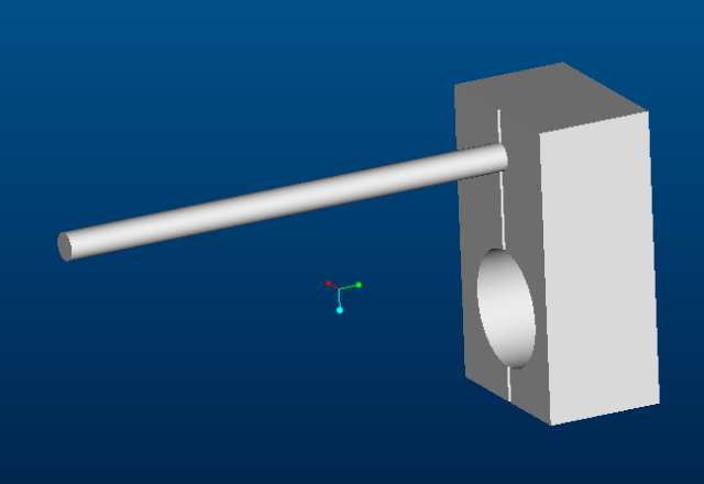

if you access to a band saw and a drill press (or mill)
I "think" a tool like this could hold the CV...the rectangle part would clamp the axle, the protruding rod would go into one of the holes of the CV, this would prevent it from moving too much..only problem I see is that the rod would have to be pretty long and getting it clamped to the axle for easy removal might be a PITA...the block should be 2 piece, I "forgot" the split line on the top (IMG:style_emoticons/default/smile.gif)
