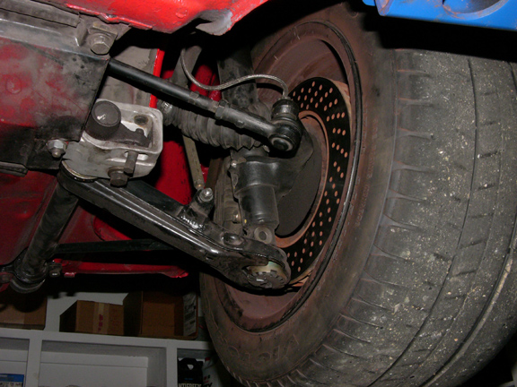

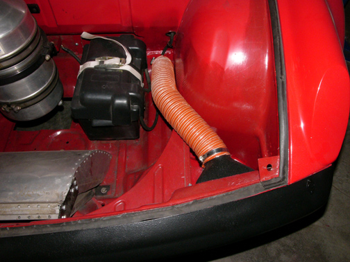

Two pictures of the vent ducts John is talking about in our de car. The air intake is where the fog light grills would be in the bumper, and the air is ducted into the center of the brake rotor which you can see in the second picture.
