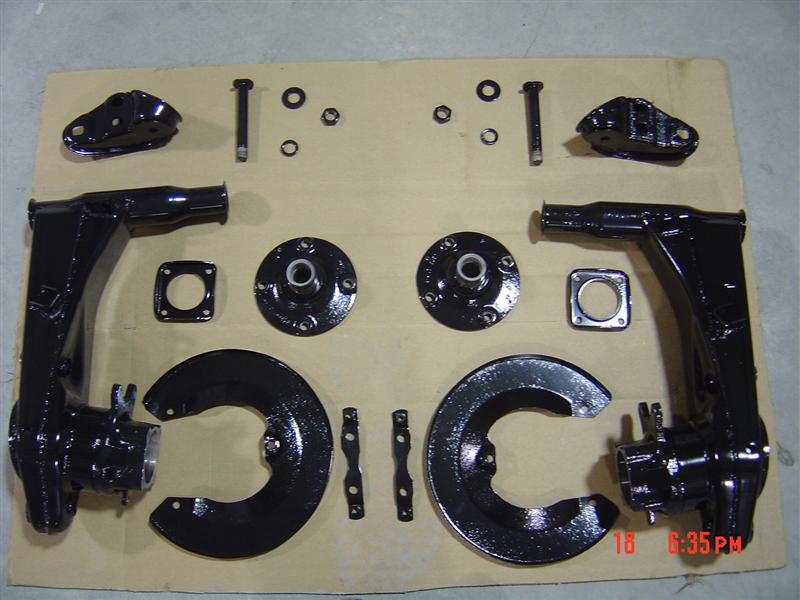

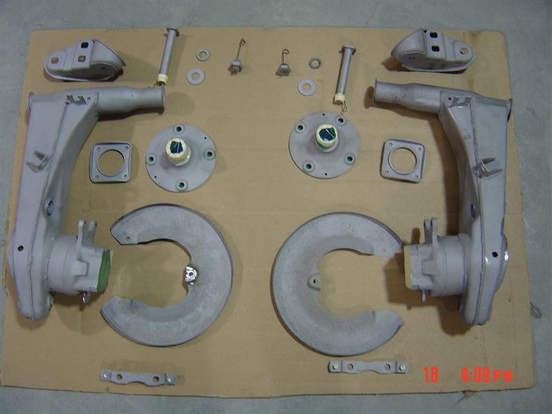

scotty b   I haven't done much of anything to the body in...   Jan 20 2007, 05:24 PM
scotty b   Same color as the trailing arms on the grills , se...   Jan 20 2007, 05:25 PM
scotty b   Engine in gloss black and a "silver" I s...   Jan 20 2007, 05:27 PM
scotty b   The silver color is actually a "semi gloss...   Jan 20 2007, 05:30 PM
scotty b   One more   Jan 20 2007, 05:32 PM
scotty b   Obviously some minor things to finish up on the en...   Jan 20 2007, 05:35 PM

scotty b   Got some more powder coating done. Front end is of...   Feb 10 2007, 03:47 PM

Johny Blackstain   Scotty- do you do all your own powder coating? If...   Feb 11 2007, 10:04 AM
scotty b   Scotty- do you do all your own powder coating? I...   Feb 11 2007, 04:57 PM
