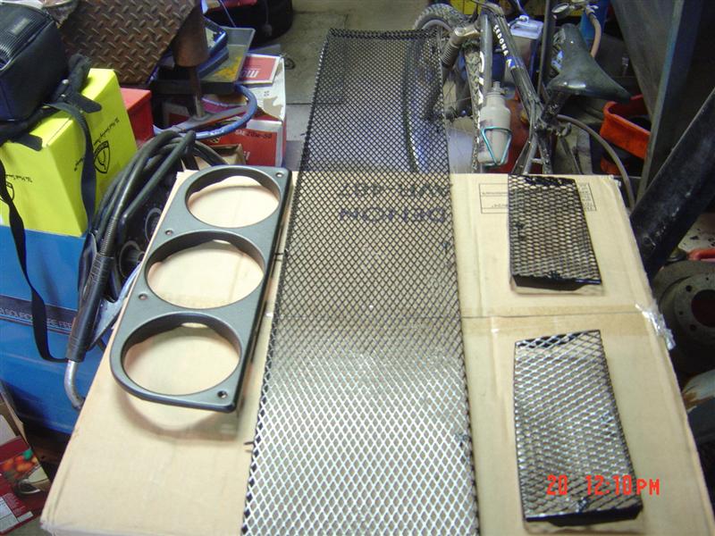

Same color as the trailing arms on the grills , semi gloss black. Gauge surround is a textured black.

scotty b   Same color as the trailing arms on the grills , se...   Jan 20 2007, 05:25 PM
scotty b   Engine in gloss black and a "silver" I s...   Jan 20 2007, 05:27 PM
scotty b   The silver color is actually a "semi gloss...   Jan 20 2007, 05:30 PM
