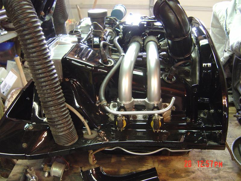

scotty b   I haven't done much of anything to the body in...   Jan 20 2007, 05:24 PM
scotty b   Same color as the trailing arms on the grills , se...   Jan 20 2007, 05:25 PM
scotty b   Engine in gloss black and a "silver" I s...   Jan 20 2007, 05:27 PM
scotty b   The silver color is actually a "semi gloss...   Jan 20 2007, 05:30 PM
scotty b   One more   Jan 20 2007, 05:32 PM
scotty b   Obviously some minor things to finish up on the en...   Jan 20 2007, 05:35 PM

stepuptotheMike   Wow... that engine looks great! :thumbsup: ...   Jan 21 2007, 07:34 AM
JPB   Wow thats a Galiath undertaking mister. At first ...   Jan 21 2007, 07:53 AM
