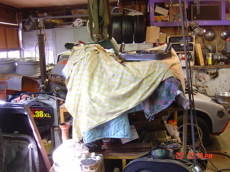

Anytime you'd like Johnny! I have actually been thinking about a get together down here BUT I don't have anyplace suitable right now. I will be offering trailing arm rebuilding/powdercoating services to people here soon and if that werks out I will be renting a small shop, so maybe that would be a good place for a gathering. As for one or 2 people you're more than welcome to come to my parents house one satuday! Just be prepared for the clusterf-ck that is my garage (IMG:style_emoticons/default/sad.gif)
