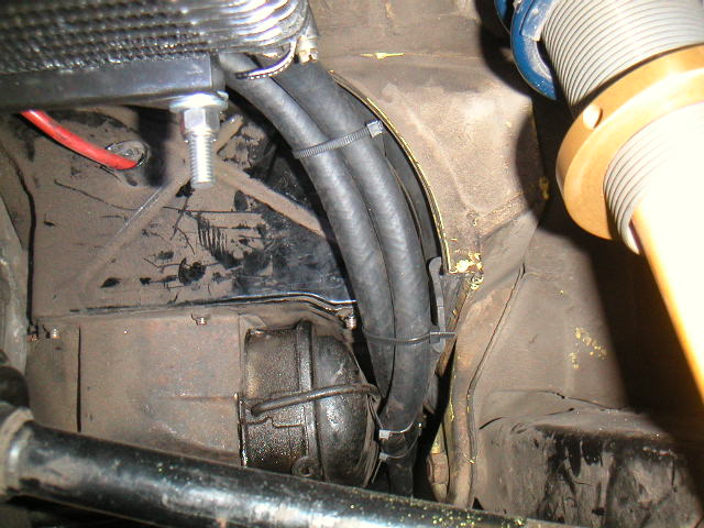

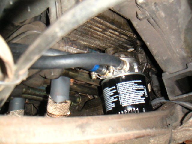

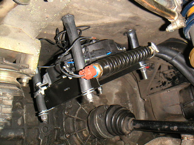

Some progress from today and tonight. re-did the oil cooler, I didn't like how tight it was to the underside of the trunk. Didn't come out quite as well as I had hoped, but its pretty good overall.
Since these photos the threaded rod has been cut off closer to the nuts, and some protection had been added to the hoses where they run across the edge of the engine metal. The black ground wire has been run under the trunk and now grounds with the transmission ground strap. I need to get a relay installed, and connect the power for the fan, and this part of the project is done.
