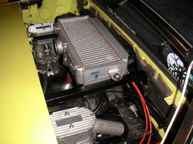

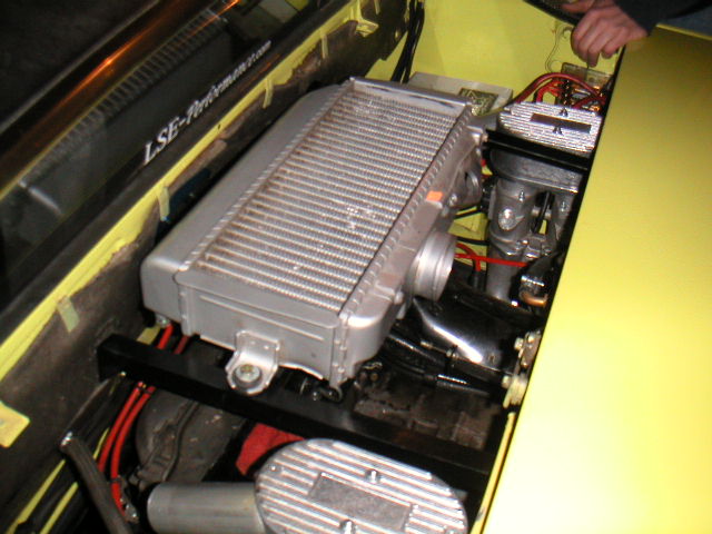

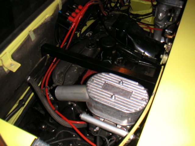

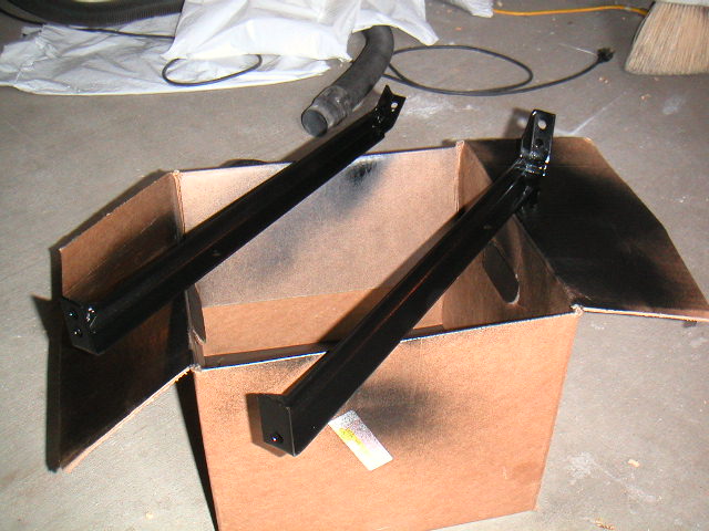

Also got the fancy intercooler mounts, made by our own fearless fabricator, Dave-O, painted with several coats, installed, and intercooler mounted. I expect the IC to come out for other work to be done, but its kinda cool to see it mounted up, ready for piping.
