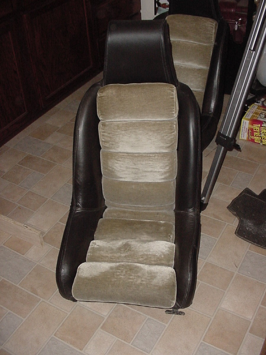

The shoulder thing makes all kinds of sense, but it makes the seat HUGE!
I'm older than I was when I was 16-18 and I prefer some COMFORT. I like padding.
I highly recommend padding the seat bottom and the seat back.
For reasons that I do not understand, someone in their infinite wisdom decided to contour the stiffener ribs in the seat back TOWARD your spine instead of away from it. Too thin of padding there hurts my spine right in the middle of my back. Without ample padding in the seat bottom gives me a real Pain in the Ass (literally).
I have tried it both ways, and actually added padding to the seat back in the track car. (you know where if you look at the pictures posted above).
Here is a shot of my street car seats. Not all leather, but I don't stick to them in the hot summer sun either.

trekkor   I'm still happy... KT   Feb 8 2007, 04:26 PM
dflesburg   Done in sofa grade leather... http://www.valhall...   Feb 8 2007, 04:31 PM
dflesburg   http://www.valhallaracinginc.com/914_pics/seats3.j...   Feb 8 2007, 04:32 PM
trekkor   Those seats look really cozy :idea: KT   Feb 8 2007, 04:59 PM
ChrisNPDrider   Wow, it's like a 914 love seat in your garage ...   Feb 8 2007, 06:42 PM
dflesburg   old pics, they are in the car now... and I have th...   Feb 8 2007, 09:32 PM
John   The shoulder thing makes all kinds of sense, but i...   Feb 8 2007, 10:05 PM
So.Cal.914   I highly recommend padding the seat bottom and t...   Feb 9 2007, 12:30 AM
trekkor   I can still use the stock seat cushion and tuck aw...   Feb 9 2007, 12:14 AM
