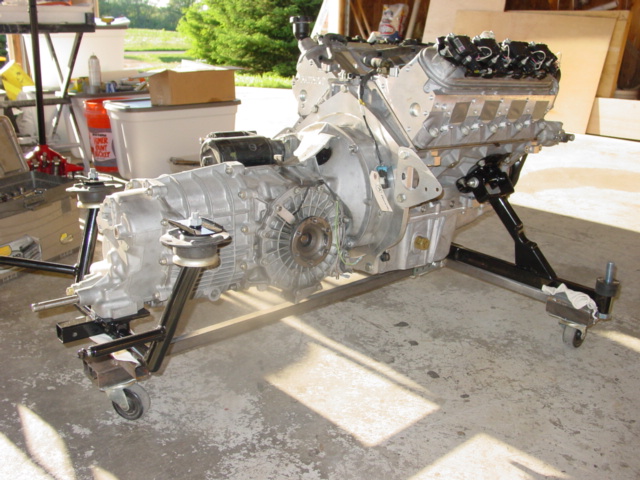

Is this really a 915 transaxle....Wanna get one for a V8 Conversion....not sure how to identify one and tell the difference between a 915 and the 901 that comes in these cars....?

915 attached to LS6

914Sixer   The case halfs should have stampings on the side s...   Feb 11 2007, 07:41 AM

propricer   915 is not well suited to V8's due to gearing ...   Feb 11 2007, 09:48 AM
wbergtho   All true...I blew the 2nd gear right off the pi...   Feb 11 2007, 10:25 AM
