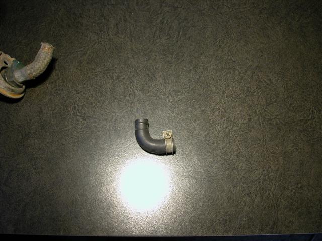

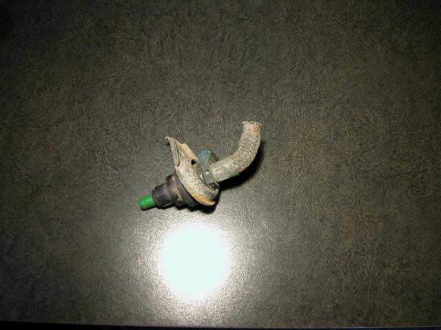

Here are the OEM fabric injectors for a 2.0L and a pic of the Recall formed injector hose just for you Pat.
Notice how the OEM injectors are formed too! The rubber replacement hose also has the proper Porsche recall clamp.
IMHO its either with the Bosch supplied fabric hose (yuck) or the recall formed elbow.
I am a pain in the ass aren't I? (IMG:style_emoticons/default/idea.gif)
