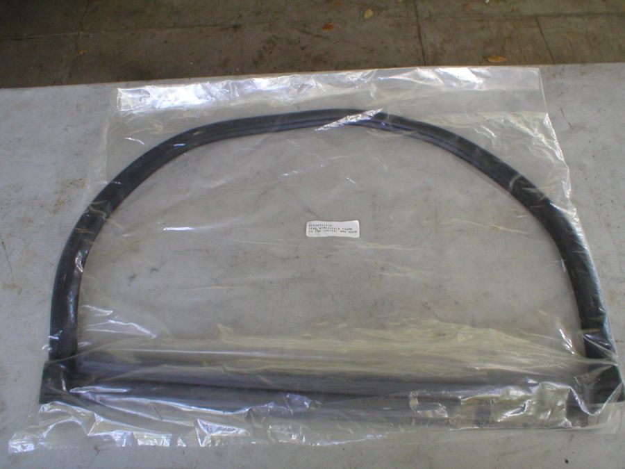

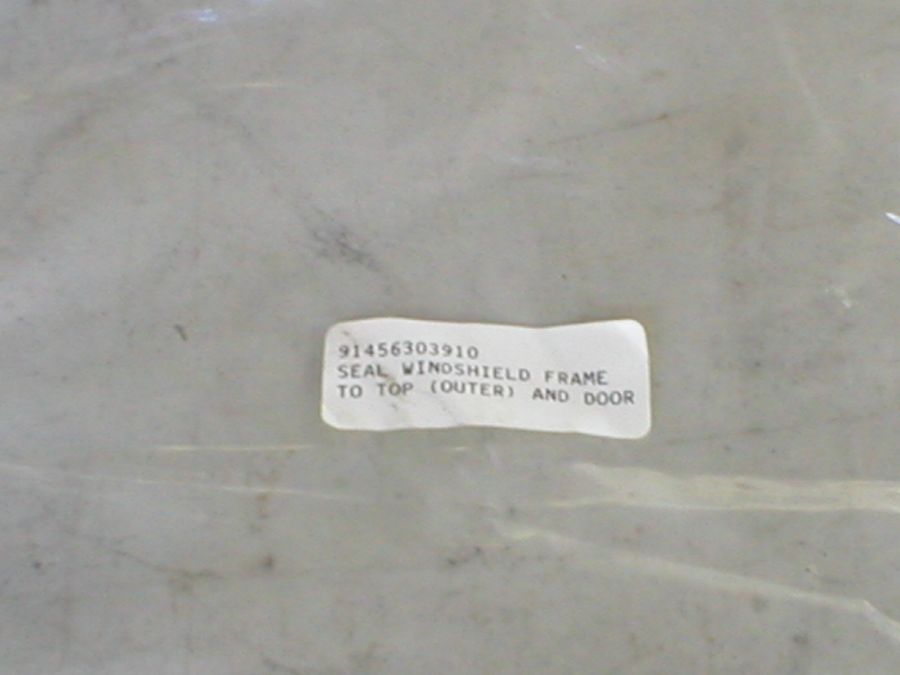

I also installed a piece that will increase the value of the car by $1000.... (IMG:style_emoticons/default/biggrin.gif)
