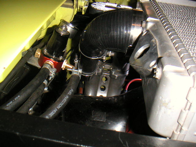

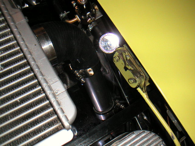

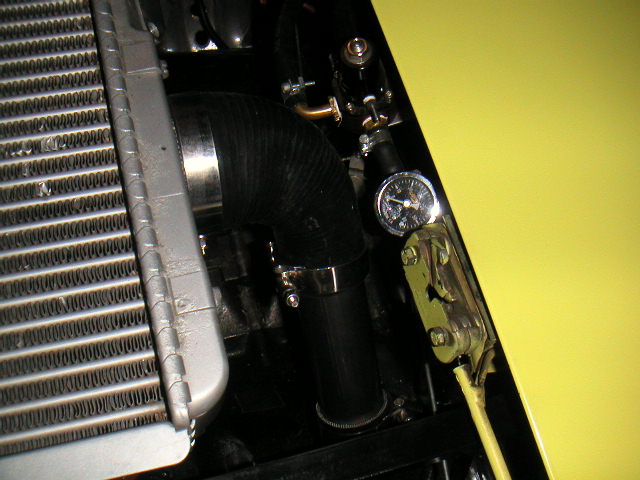

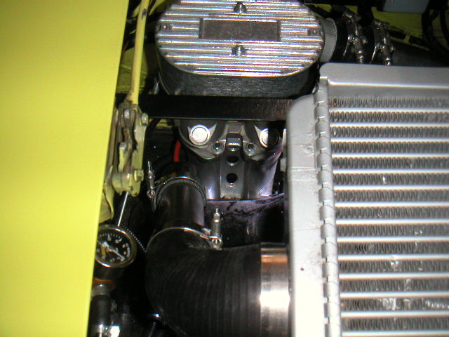

Here are some shots of the back of the intercooler, and the line to take in the boost from the turbo. I found a place for silicone that made a 3" to 2" 90 degree elbow, which was exactally what I needed. I still need to run the line thru the engine back metal to connect to this line off the intercooler.
