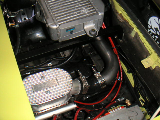

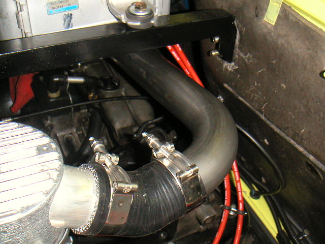

post Apr 1 2007, 07:24 PM
The glory that once was.
Posts: 1,302
Joined: 15-December 03
From: Mahtomedi, MN
Member No.: 1,438
Here are the connections for the right side ITB. I needed to use a 45 degree silicone elbow to make this side line up a little bettter. As noted, once the final adaptors are made for the connection to the intercooler, the allignment may change a little, but this is basically how it will go.
