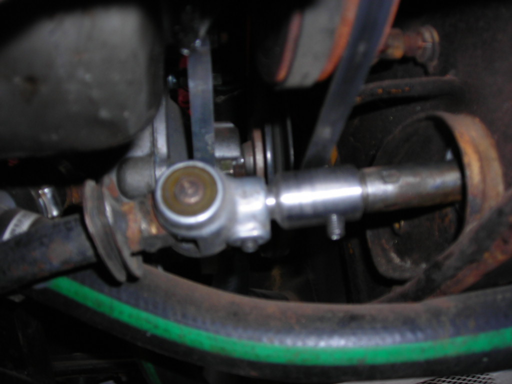

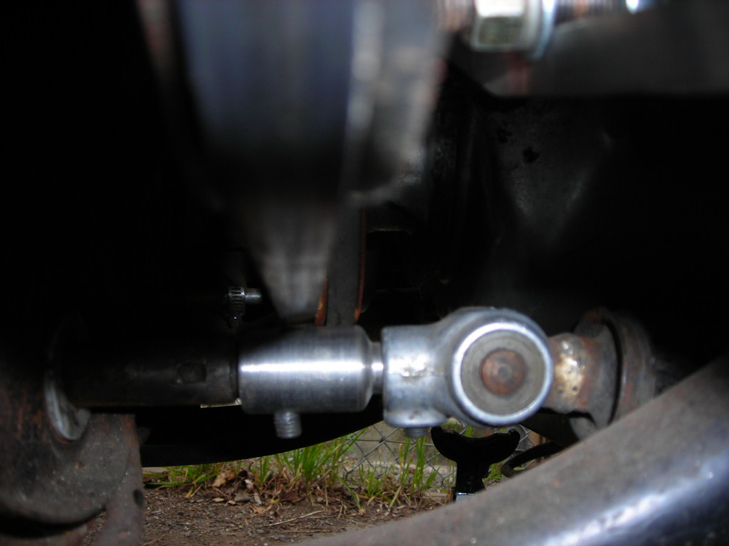

I actually got some time on my V8 car Sunday. Had to jack it up to take ant's view pics for a potential buyer.
Installed the "Mueller" extension and it fit perfectly. Have about a 1/8" clearance of the water pump belt. (IMG:style_emoticons/default/biggrin.gif)
If interested in buying an extension, PM Mueller.

neo914-6   I actually got some time on my V8 car Sunday. Had...   Apr 3 2007, 01:46 AM
neo914-6   the differences between the bolt-on extension and ...   Apr 3 2007, 01:48 AM
neo914-6   other side   Apr 3 2007, 01:50 AM
McMark   I do my share of 'mangling' stock parts, b...   Apr 3 2007, 03:53 AM
Mueller   Glad it worked...sorry we missed lunch today, hope...   Apr 3 2007, 03:30 PM
